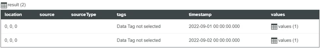

September 16, 2022
use below service
Things["TestStream"].AddStreamEntries({
	values: dataset/* INFOTABLE */
"dataset" is the nested infotable as below, which uses "StreamEntryWithValues" datashape.
In "StreamEntryWithValues" datashape, there is one infotable field called "values"
In "values" infotable, you will have your own data set.
Each row consider as one entry in stream.
Hope it helps
