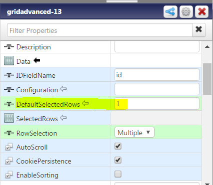

    Which version of advanced grid are you using. In the latest version of Advanced Grid available on ThingWorx Marketplace; there is a property to set the DefaultSelectedRows. You can set it as 1 to auto select first row.
    You would also need to change theRowSelection to single/Multiple for DefaultSelectedRows to work
