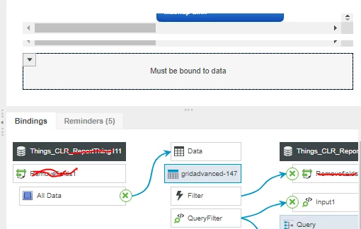

Advanced Grid bind with service but grid showing message - Must be bound to data.
Actually i bind Advanced Grid with a service to see the data which is going to be fetched from Service, but after the binding also the Advanced grid showing Must be bound to data. So any one please help , how to solve this issue.
Thanks and Regards.
If you save the mashup and click the "view mashup" button, does it not show any data?
Also, I have a faint memory that if the service that provides the data to the grid is not triggered in some way, this happens.
Here are also some PTC articles you might want to check out:
https://www.ptc.com/en/support/article/CS328691
https://www.ptc.com/en/support/article/CS338616
Not sure if they apply for you as it depends on what version of Thingworx you are using.
