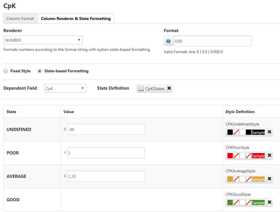

I am trying to use the Advanced grid to display data, and one of the grid columns i have applied a state definition to. This works fine with the regular grid, but it is giving me issues with the advanced grid. The Default state definition does not seem to be taking.
Advanced GridRegular Grid
Here is the Grid Column where the State definition is set.
Could anyone please help me out? Thank you!
