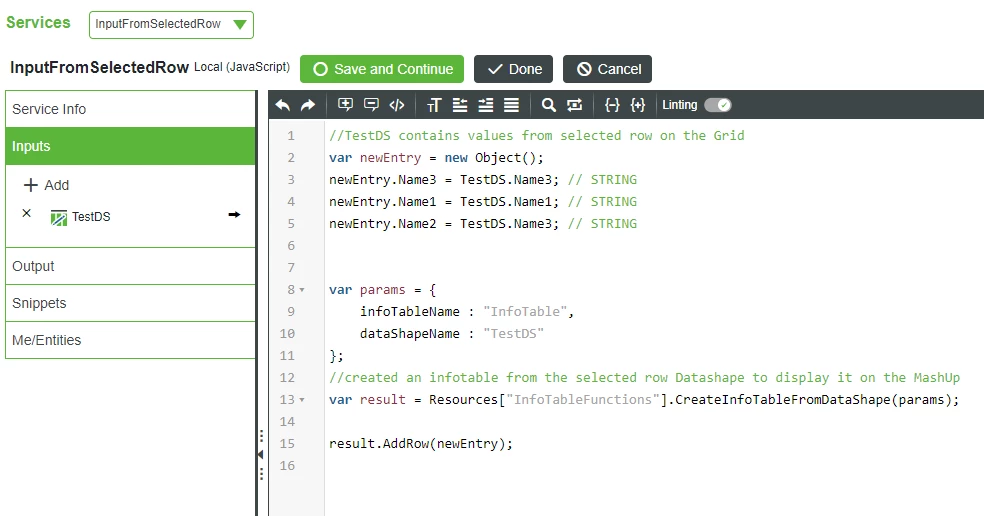

I would like to add that you can capture the values of the selected row by binding the SelectedRows property of the Advanced Grid widget to a service. Please follow the below steps to achieve this.
  • Create a DataShape that has all the properties of a selected row from your Advanced Grid.
  • Create a service with input base type as DataShapeName and set the default DataShape to data shape you have created in the above step.
  • Bind the SelectedRows property of the advanced grid widget to this service.
  • Please ensure that the RowSelection option is set to Single/Multiple (as per your requirement) from the advanced grid widget properties.
  • You can now access the properties of the selected row from the advanced grid inside this service.
Please find the attached images for your reference.

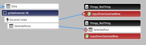

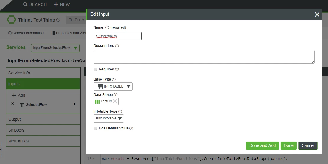

Minor modification to the implementation I have stated earlier. Instead of choosing the input of base type DataShapeName to the service, set the input parameter of base type to Infotable. Bind the SelectedRows property of the advanced grid widget to the service and trigger the service upon the double click event.
Please find the attached image for reference. InputFromSelectedRow is the service which accepts an Infotable as it's input.
