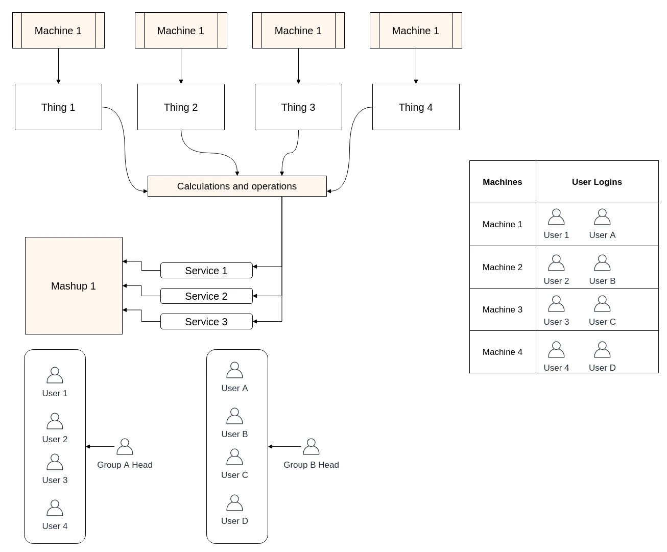

Advice for design and implementation of the below architecture.
I needed suggestion on designing and IOT application.
I am going to describe it with an example flow which is similar to my existing requirement.
-> Consider there are 2 groups of users with a group head each. Each group have 4 members.
-> There are 4 machines and respective 4 things created in thingworx( whose parameters are linked to machine tags)
-> Each machine's data, information and related operations will be assigned to particular users from both the groups
-> There is one general mashup designed, which will should the respected machine information when the respected user login's to the application.
-> And there will be common set of services designed that will be linked to the mashup.
Question:
How to display data and information of different machines, when that respective user log's in the application(Mashup) on that same Mashup.
I have drawn a diagram for better understanding.
Now is need some advice on how to achieve this architecture .
Sri1
Make sure you understand TWX security--specifically visibility for organizations on a thing.  TWX will automatically control whether a user has access to a thing based on the assigned visibility.  So when you "GetImplementingThings" or do any sort of search, only the things to which the user has access will be returned.  Your services can aggregate your data and you can be assured it's only aggregating the info for the things the current user can see.
