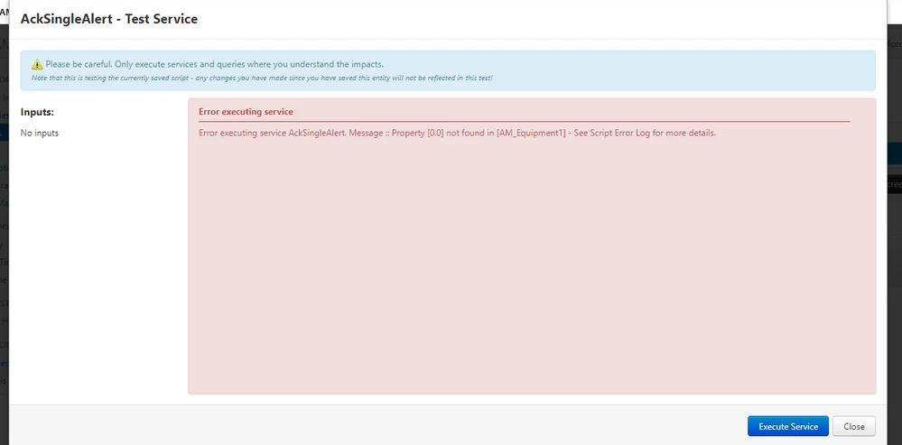

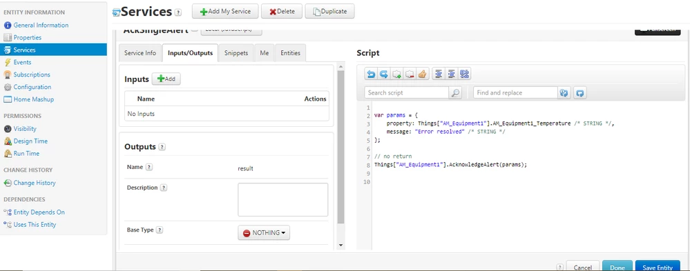

I am trying to acknowledge an alert with property using AcknowledgeAlert service but the result shows error. But when I try with AcknowledgeAllAlerts it works fine. How can I acknowledge a specific peropert alert?
1) And where can I fetch the details of all the alert that have been acknowledged previously?
2) Using subscription "AlertAck" is it possible to save the details to sql database upon acknowledging a specfic alert?
Thanks in Advance,

Best answer by PaiChung
For the Property parameter, you just need the name of the Property, since the Acknowledge service is already being executed in the context of the Thing itself.
So you don't need Things[ThingName]. just the PropertyName is needed in the parameter block setup.
