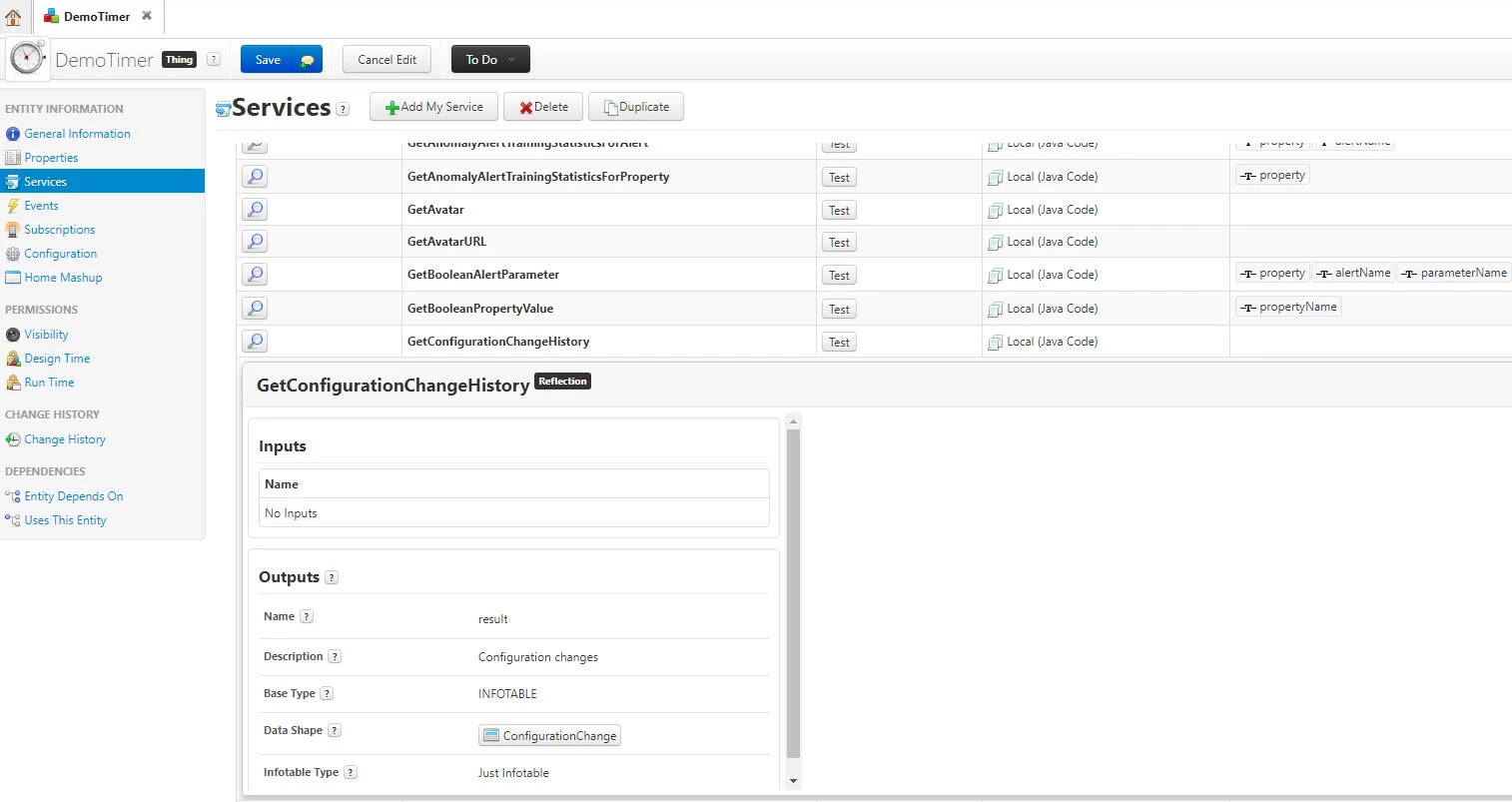

 @arvind9441 this service is available in the Services section for your Thing (largely any entity) you can check this by navigating to the Services section and look for the GetConfigurationChangeHistory
The usage is pretty straight forward as its not taking any input parameter, so if you are looking to call this for certain entity you can do something like this
var result = Things["DemoTimer"].GetConfigurationChangeHistory();
DemoTimer is just the name of the entity on which i'm calling GetConfigurationChangeHistory()

Hi @arvind9441 if these properties are added manually from the composer they'll show up in the change history for the Thing and you can query the same using GetConfigurationChangeHistory() and based on the diff an alert could be generated, however current limitation with Change History in general is that if any change is applied to the Thing programatically it doesn't reflect in the Change History. There's already an enhancement request being worked upon as noted here Updating/Editing Entities programatically in ThingWorx does not update the Change History of the entity
