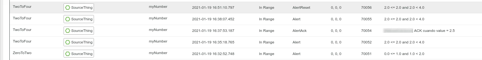

I have a number property on a thing with two in range alerts (0 <= value < 2; 2 <= value < 4).
When doing the following steps I sometimes miss the AlertReset events in the Alert History.
Init: value = 0
1) value = 1
2) value = 2
3) value = 2.5
4) Ack
5) value = 3
Why might this be happening and how to narrow down the problem? Any suggestion is welcome!

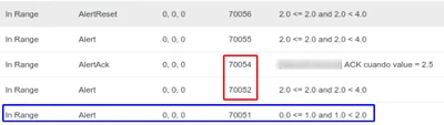

Hi @anarwal
Acknowledgement seems to work ok. The issue is related to the AlertReset event.
When the value=2 I expected to see an AlertReset event for the 0<=value<2 rule [Highlighted in blue] (I guess that if it would get logged it would have the 70053 ID that's missing [Highlighted in red])
