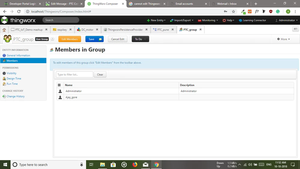

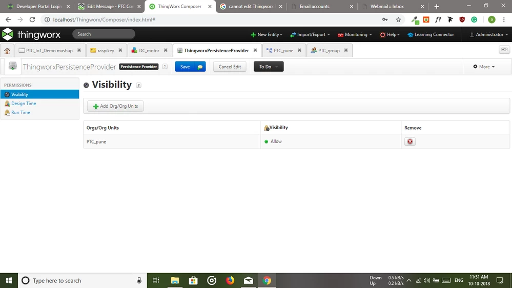

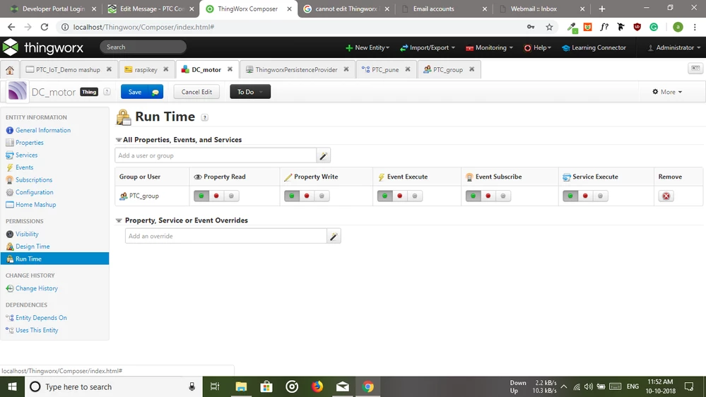

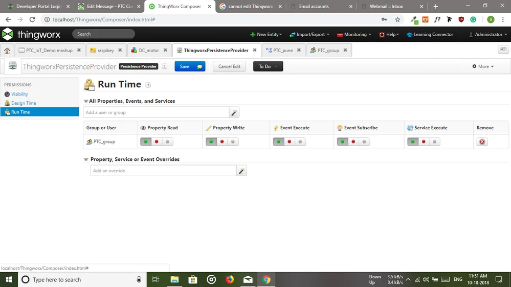

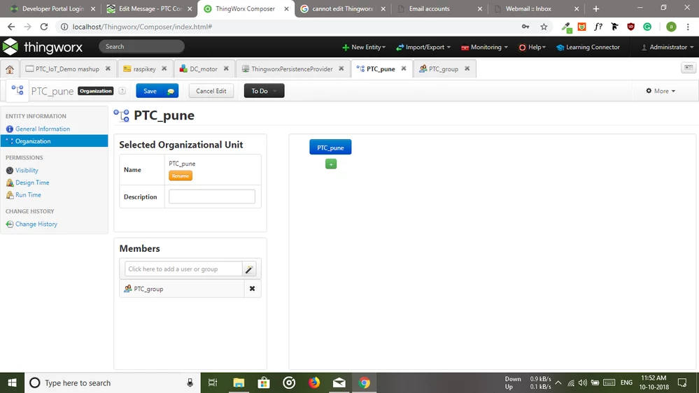

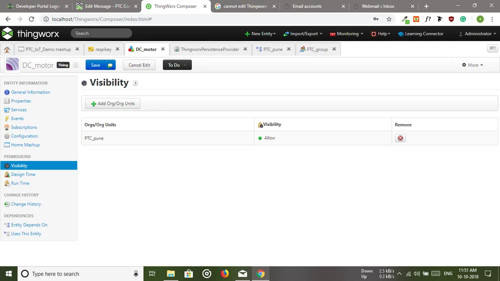

Oct 10, 2018 5:38 AM UTC
thank you for replying me.
i saw the the link you gave. in that article it says  "Add Visibility for the System User on ThingworxPersistenceProvider.
i added visibility for whole group and organization for ThingworxPersistenceProvider but still problem exists.
my Thingworx version is 8.2.1-b140.
Screenshot (66).pngScreenshot (67).pngScreenshot (68).pngScreenshot (69).pngScreenshot (70).pngScreenshot (71).png
