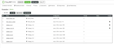

How can I get the list of all the alerts that are configured for each Thing.

Using GetAlertStatuses service/API will return a list of alerts configured for a Thing. Also you can use this service at ThingTemplate level.
  • custom service: Things["ThingName"].GetAlertStatuses();
  • OR send POST request to http(s)://host:port/Thingworx/Things/ThingName/Services/GetAlertStatuses
However you will only get alertnames, property and status information but not detailed configuration/condition of each alert.
You will probably need to loop through the above result and use service like GetAlertDefinition to get detailed alert condition.
