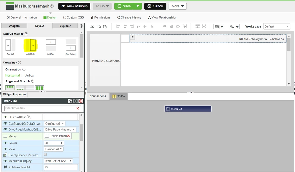

I have a menubar in my header flexcontainer and set all alignmentsettings to "right". But the result is shown on the left end.
Could you provide me some help?
And this is the result

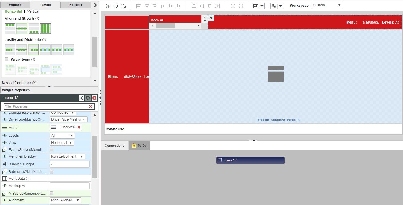

Hi @Christian_S.
The closest I was able to get was to add another layout over the existing one and then set that to right-justify:
Give that a try to see if it will get you closer to what you were looking for.

June 26, 2019
Badly that didn't help 😞
I added a new Layout on the right and set the alignment and added the menu with right aligned items.
The output I got was the same as before.
As you can see my menuitem stays on the left side of the menu which fills the whole layoutcontainer.
I made a test with two buttons instead and than the buttons were aligned right as expected. So I think this could be a problem with the menu widget.
