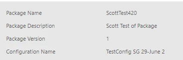

How do you get data in the ptcspropertydisplay widget to display in two separate columns?  The property from it's value.
In propertydisplay widget it looked like:

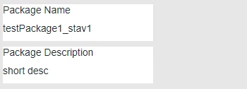

Now in the ptcspropertydisplay widget it looks like:

Hi @SG_9149098
What version of ThingWorx are you using?
I guess you'll have to give the widget enough space (width) to let it showing horizontally (leave VerticalMode property unchecked).
August 23, 2022
8.5.9
August 25, 2022
I have verified the display in the Legacy Property Display Widget. The new Property Display widget (ptcpropertydisplay)is provided to display the group of data points, like n number of columns under one group, for more details you refer the link.
https://support.ptc.com/help/thingworx/platform/r9/en/index.html#page/ThingWorx%2FHelp%2FMashup_Builder%2FWidgets%2FPropertyDisplayWidgetThemable.html%23
You can use the Legacy Property Display in 8.5 (also in 9.3) for your required display. Or you can use Grid Widget to display with column
