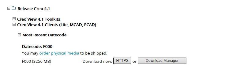

Aug 30, 2017 9:04 AM UTC
Hi Yijun,
I consult with Creo View engineer, it should be Creo View Clients.
Best Regards,
Lily
