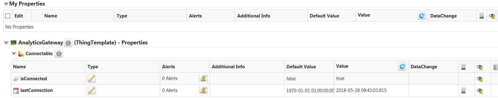

Hi, Was your ML entity showing isconnected= true ? Did you find any logs from TWX or TWA side about it?
May 28, 2018
thank you for your reply.
Entity is showing isconnected=true

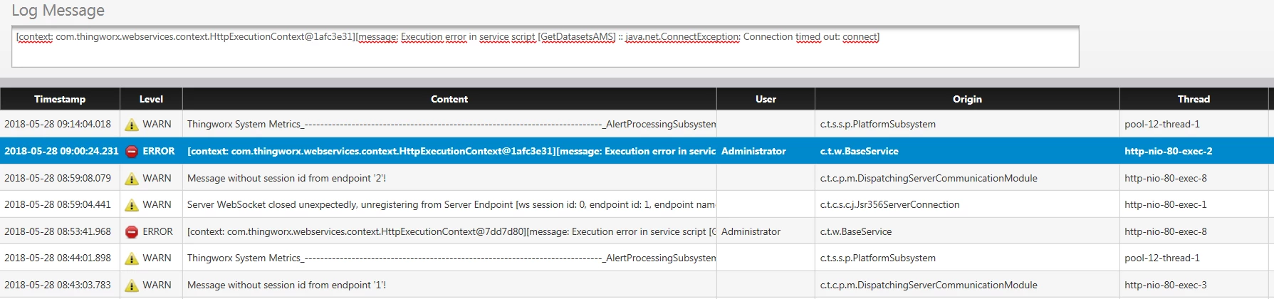

and I get following Error in logs:
[context: com.thingworx.webservices.context.HttpExecutionContext@1afc3e31][message: Execution error in service script [GetDatasetsAMS] :: java.net.ConnectException: Connection timed out: connect]
please see attachment
Thank you
