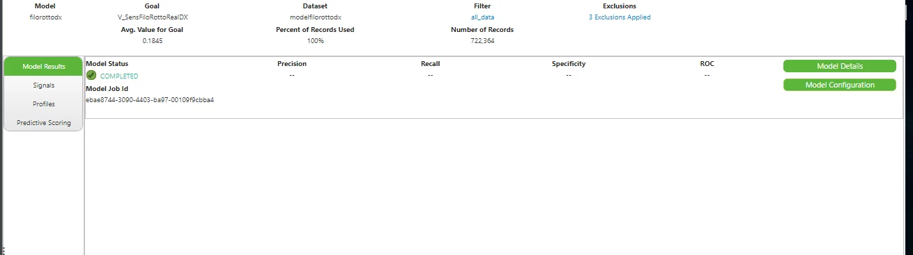

Hi everyone,

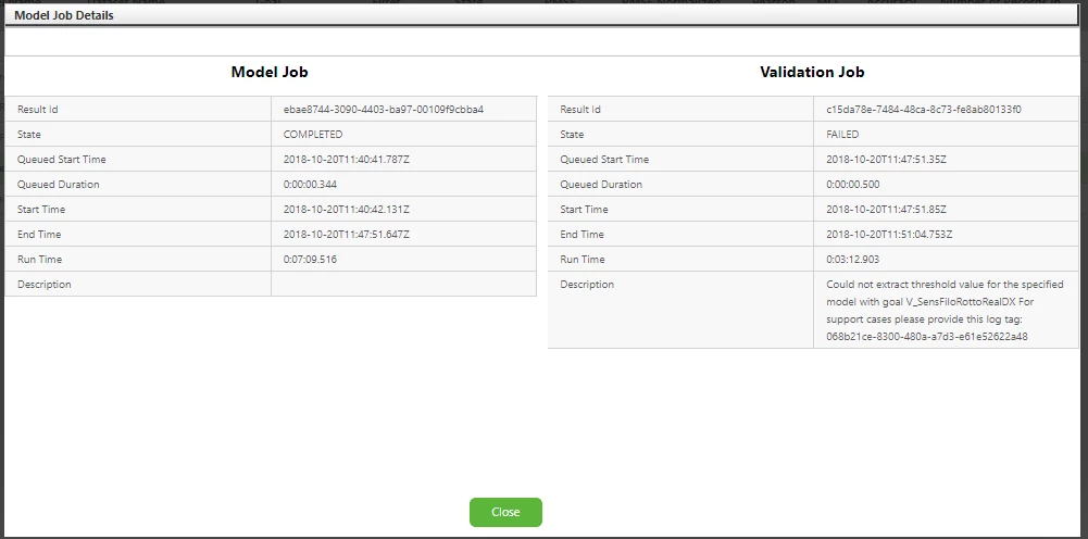

When I'm creating a Boolean Goal model in Analytics Builder, it finished everytime in a failed statement.
Please find below the error:
"Could not extract threshold value for the specified model with goal V_SensFiloRottoRealDX For support cases please provide this log tag: 068b21ce-8300-480a-a7d3-e61e52622a48"
My release is 8.3.2
Anyone could you help me?
Please find image attachments.
Thank you so much

Hi Elia
Thank you for this.
I was able to reproduce this with non English Regional Settings for system accounts.
Could you follow the steps in https://www.ptc.com/en/support/article?n=CS294946 to confirm if it help s ?
