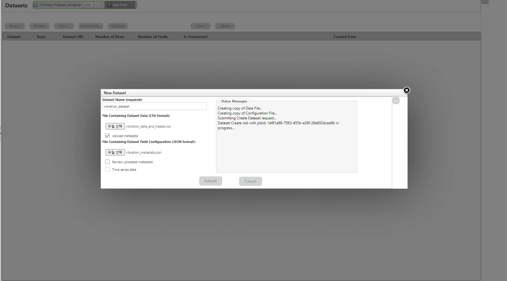

I'm practicing by installing an Thingworx anaytics in developer build a predictive analytics model.
Error occurs. data set stops everytime.
Please refer to the attached picture

Hi @JackEom
Can you check if the twas-zookeper service is started, if not check https://www.ptc.com/en/support/article/CS285428 to correct.
If it is, then execute the TWALogCollector (https://www.ptc.com/en/support/article?n=CS316782) and upload the zip file created.
Christophe
