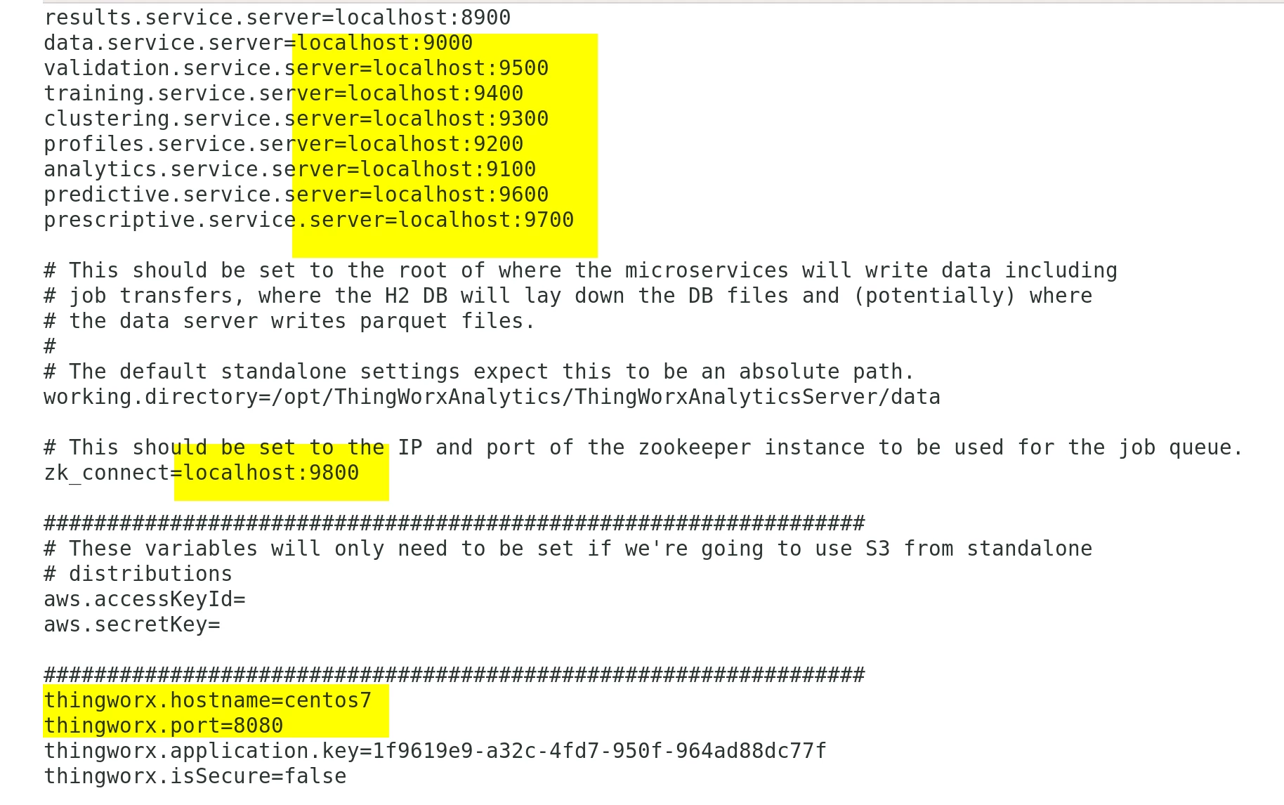

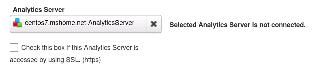

I have Thingworx platform and Thingworx Analytics installed in a CentOS VM on my laptop. It was working fine until, the IP address of the VM changed (or so I suspect, may be something else also might have affected this).
Please see the attached snapshots - all configurations are with localhost. I haven't used any IP addresses while configuring the Analytics and everything is on the same VM. Is there a way to get edge logs to see whats the error? I do not see anything useful in the Thingworx logs or Analytics logs.

Due to these investigations, I was able to find the root cause of the issue. The Java JRE path was hardcoded with specific Java JRE version. It was updated when I installed some other component on the VM as a result breaking the services. I have updated the services and it is working fine now.

Hi @SajidPatel
From the properties file it appears that ThingWorx Analytics connect to ThingWorx using the hostname centos7.
Given that this is a VM I am guessing this is a local name resolution via /etc/hosts file.
So maybe the ip settings in /etc/hosts for this hostname is not up to date anymore.

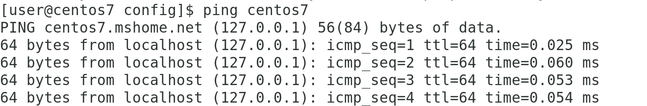

You can try ping centos7 in a terminal to check if it responds.
Regarding log files, those depends on the version of ThingWorx Analytics used, the article https://www.ptc.com/en/support/article?n=CS268761 will tell you where to find them based on the version.
Hope this helps
Kind regards
Christophe
April 1, 2019
@cmorfin Thanks for responding
 centos7 is the localhost. ping works fine, please see the attached screenshot.
