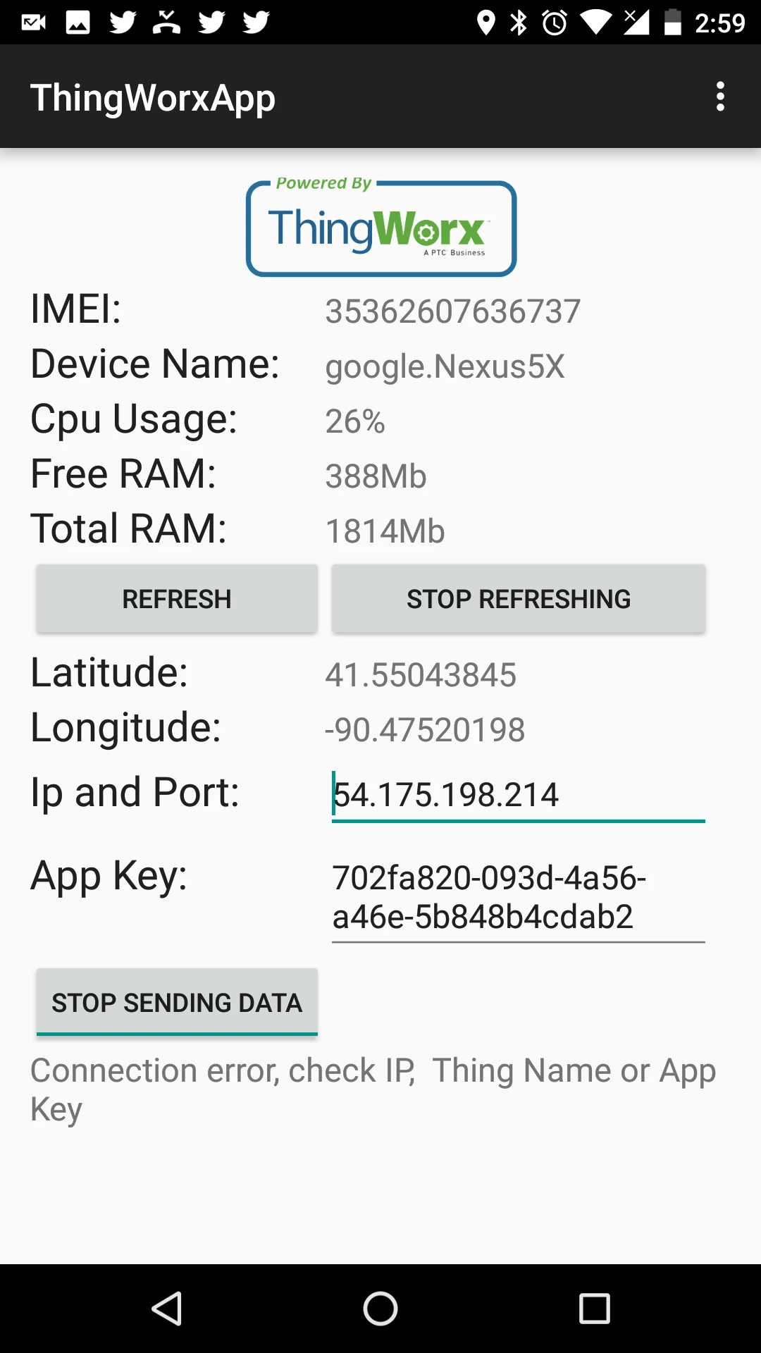

I did whats been documented in the PDF file step by step.
I am using ping dtudk.cloud.thingworx.com and getting 54.175.198.214 as IP Address and thats what i am using in the phone.
Also I made sure the following:
Uncheck the Filter Content-Type in Configuration of platform Subsystems.
Allow request method switch is checked.
Verified the Keys and they are the same.
When i press the button send data I get the error Connection Error, Check IP, Thing Name or App key
I need to make sure this is working so that I can demo this to my FTC team.
Appreciate a quick response.

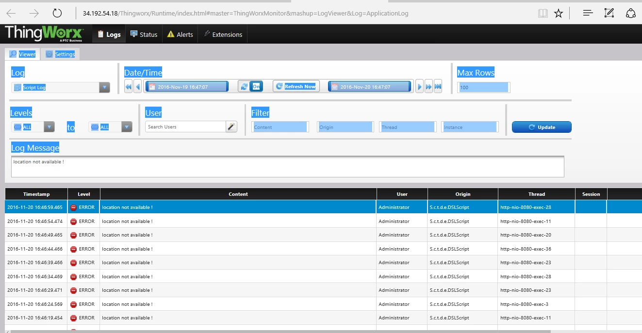

    Ram, I see you've added the IP but didn't include the port details on that, so please try adding 'ip:port' on that section. On a side note, the ip address on the screenshot looks to be different from the one you have on the capture. Is that a different instance?

    Hi Aanjan,
    I used the port 8080 and I still not getting the result. I was a bit confused on your second part of the note.
    The screen shot 34.192.54.18 is from the 30 Day Trial Foundation Server.
    Do I need to use this IP address on my phone? I was using the IP address from (ping dtudk.cloud.thingworx.com) which was mentioned in the tutorial?

    November 30, 2016
    Ah I though you were trying to connect to your server; that's why you posted the screenshot. Can you re-verify if the server is running on port 8080 and not 80?
