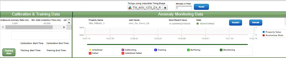

Hi all,
I have a problem to show the property values in anomaly dashboard mashup.
The alert is in MONITORING status but the graphic is empty.
While is training, it works fine creating the correctly result and training database.
could you help me?
Thanks.

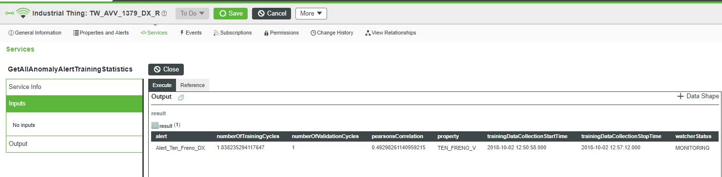

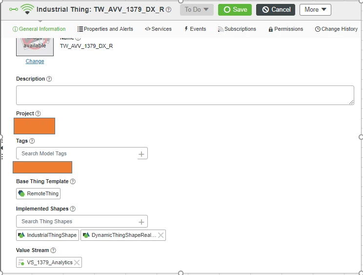

Could  you send the output / screenshots of:
- General Information page in Composer of thing TW_AVV_1379_DX_R, showing the template, implemented shape, value stream

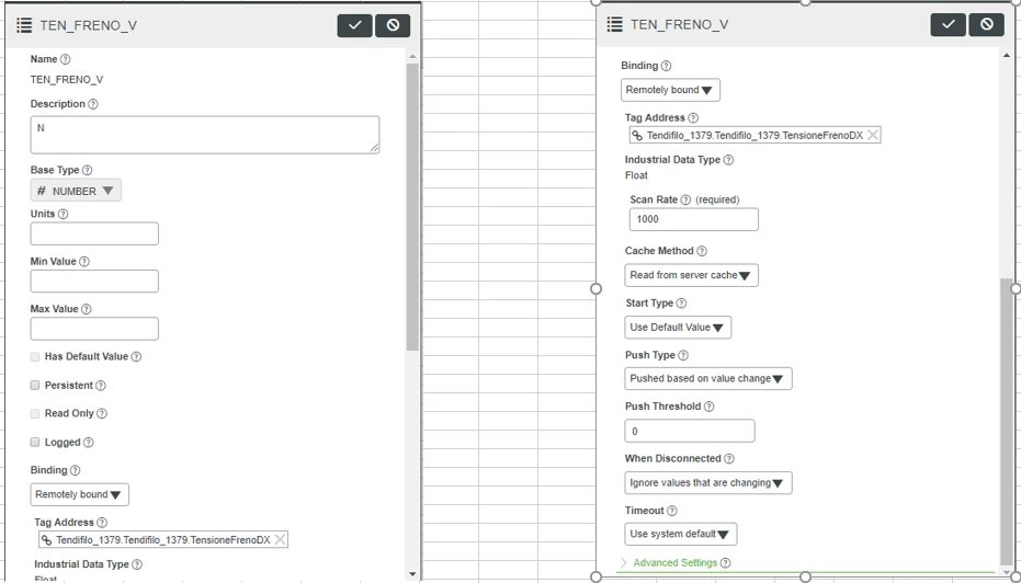

- Properties page of the same thing showing definition of property TEN_FRENO_V

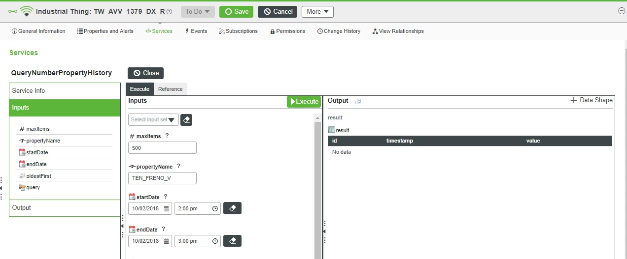

- output of service QueryNumberPropertyHistory for property TEN_FRENO_V between  14:20:00 and 14:40:00
- output of service GetAllAnomalyAlertTrainingStatistics

No, I was saying that it works fine in the creation of databases but it didn't work in mashup in training too.
Please find attachments.

Hi Elia
The property TEN_FRENO_V needs to be logged.
for this :
- select the property TEN_FRENO_V in the property page
- tick the Logged checkbox,
- press the "tick" icon on top of the page
- Save the thing
Wait for some data to come in, the mashup should update (this depends on the incoming rate of the data though).
Also QueryNumberPropertyHistory should output some data for that property.
