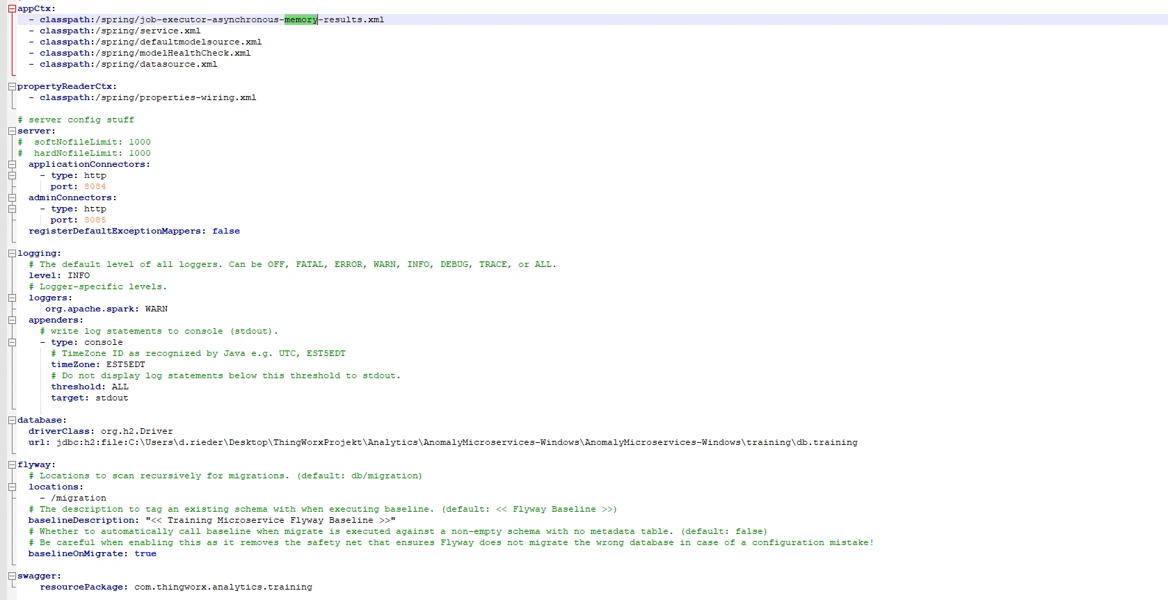

while trying to follow this guide I had a lot of problems which I was able to solve thanks to this community, but now I am facing the next one:
While trying to create an anomaly alert, it fails after a long time of Calibration. As I suspect from the log files, it seems that the data is collected properly during Calibration but it fails to switch to training mode.
Also I checked the ports for the training and result standalones and the ones I used for them are free. I also get the expected results described in the guide when visting http://localhost:8082/results/models and http://localhost:8084/training.
Attached you can find the output of the command prompts where I executed the Jar Files. (One of them is very large, sorry for that)
Any help is appreciated very much!

I am working with TWx Analytics 8.2. In my training-standalone-single.yml file I didn't see anything about "file storage". this is how my yml file looks likeScreenshot (32).png

I think that you problem is related to windows permissions.
If you have a look a the results log file you will see this error.
Failed to upload results document: Could not create folder "file:///C:/Users/d.rieder/Desktop/ThingWorxProjekt/Analytics/AnomalyMicroservices-Windows/AnomalyMicroservices-Windows/Usersd.riederDesktopThingWorxProjektAnalyticsAnomalyMicroservices-WindowsAnomalyMicroservices-Windows iles"
Try to run the jar files from an Admin command prompt or change the folder permissions.
