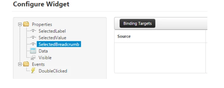

Hi Team,
Suppose I have a tree widget with network structure has been binded over it.
Autoselectfirstrow property of tree widget will provide first node to be as selected on load of mashup.
But what I want is node of tree to be selected on load of mashup lies anywhere in middle instead of root node.
Could anybody help me with the logic pls.
My Thingworx version is 8.3
Thanks in advance.
AshrithaAnswer
Dec 17, 2020 10:54 AM UTC
Use Tree grid Advanced. It has the selected rows as bindable input field.
Ashritha15-MoonstoneAnswer
Dec 17, 2020 11:39 AM UTC
@ranjank , Try writing a service  which returns me you child of first node(2nd level) and bind that data to selected label and value.
