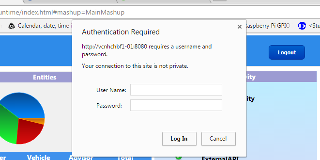

     actually i am using the FormLogin option  to access the mashup and also using Logout Widget that was working fine. but if i am clicking the logout button it shows the Authentication popup.but i want to go back to Login Form user credential page.Is any way to achieve this function.

The marketplace logout button, has a redirectionURL property where you can set the Login URL.

Hi Carles Coll
        yes, It was working fine. thak you
