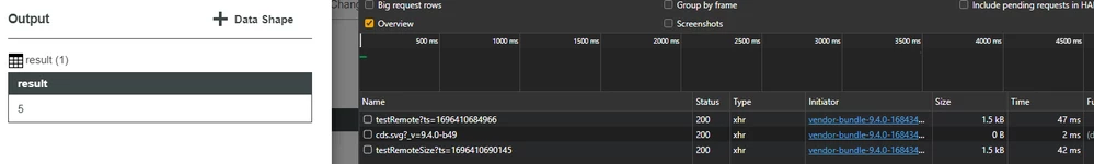

Oct 4, 2023 10:16 AM UTC
I find it strange that infoTable.length would take additional 20 seconds, if run just once.
Can you share all the service code where you observed this situation?
Oct 4, 2023 10:22 AM UTC
    let queryA = "sql query........";
    result = Things['SmartParts.DataBaseConnector-TH'].Query({
        inQuery: queryA
  //if temp infotable used to calculate length, then it is taking some more time to give results. SO using same result infotable
    let count =result.rows.size();
    if(count>0) result[0].COUNT=count;
    else result[0].COUNT=0;
