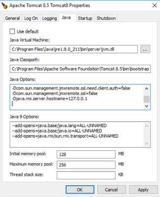

Apache Tomcat 8.5.50
After a fresh install of Apache Tomcat 8.5.50, there are settings in the Tomcat Configuration dialog box for Java 9 Options (see below).  Is it best to clear these out, or should these default values be left in?

Hi @bmehringer.
You should leave the defaults but add the additional settings needed for ThingWorx.  Please refer to this page from the Help Center with the details.
