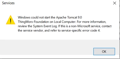

I took a look at the error messages in the log file you provided.
It looks like you have Java 11 installed and are trying to use ThingWorx 9.0.x
See the Article - CS328646 When Java 11 is installed ThingWorx Foundation installer fails because the Tomcat service fails to start
With ThingWorx 9.1.x you get the option of using Oracle Java 11 SDK
Hope that helps
Peter

Hi @MV_9521008.
From the log, there appears to be an issue with java.  Which version of ThingWorx are you installing?  Did you check the System Requirements to ensure you are installing a compatible java version?  I'll be happy to send you a link once you advise the ThingWorx version you're running.  Please advise too which O/S you are installing on.
Regards.
--Sharon
Support
Jun 21, 2021 8:31 PM UTC
Hi @MV_9521008
Apologies, I missed the version in the Title originally.  Here is the link to the system requirements for that version.
In addition, here is the link for the foundation installer instructions.
