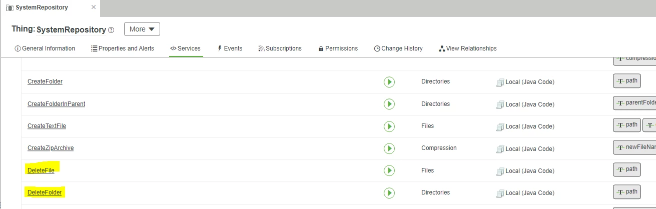

I want an API to delete all the files present in the SystemRepository.

You can use the 'DeleteFile' or 'DeleteFolder' services in SystemRepository Thing to delete files or folder
