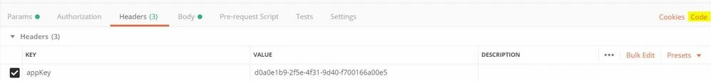

It is advised not to pass the appkey in URL. The alternate way is to pass it in header. How to do this? Does passing the appkey in headers is achevied by writing a script? Can somebody show me an example?
rjanardanAnswer
February 3, 2020
You could use Postman client to create your REST call and specify App Key in header as below. Once tested successfully, click on code to generate code corresponding to it in the language of your choice.
rjanardan16-PearlAnswer
February 3, 2020
