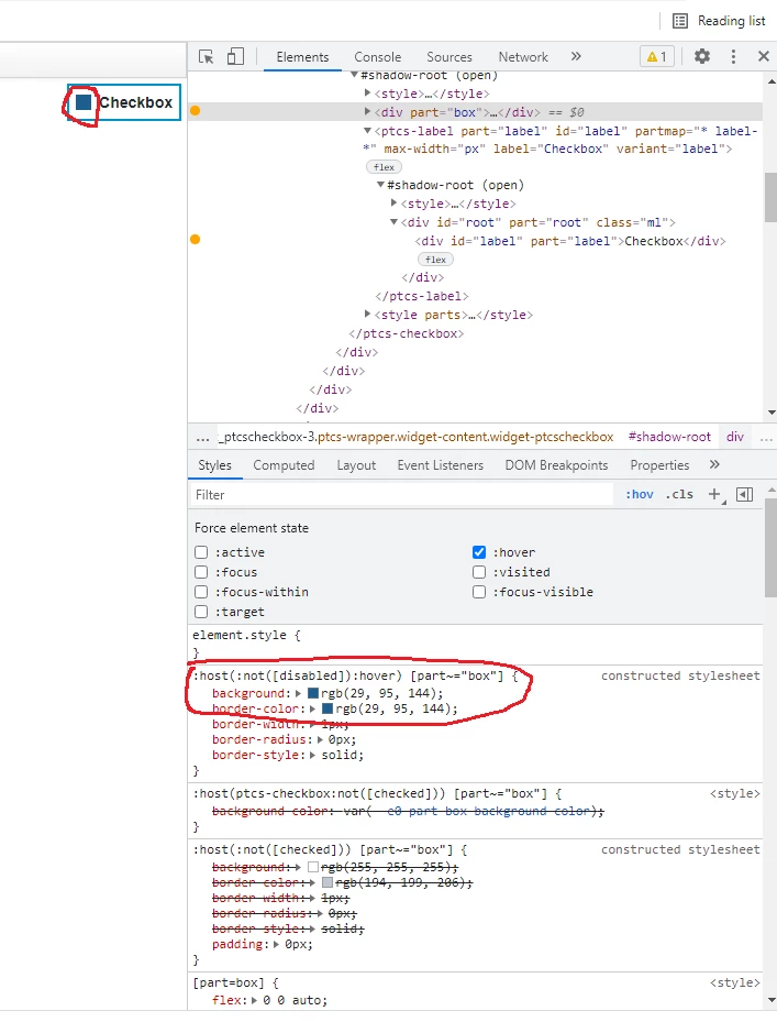

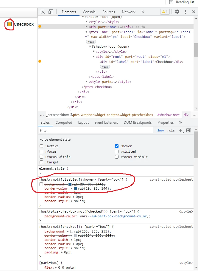

I am trying to conditionally style a checkbox widget, box background when both the box and any other part of the checkbox widget are hovered over.  However I am unable to override the default background color.  Through Google inspection tool I can disable the background color being applied and my styling apply as intended.  How can I override the defaults using custom CSS?
A theme with the custom css and a checkbox mashup have been attached for recreation.  As well as pictures showing current behavior.  Note, screen shots did not capture cursor hovering over checkbox label.

Hi Peter,
Thank you for your response.  I have modified your code as follows, and it gets me 90% there.  What I intended to do is to disable the box background color when hovering.  I am successful in doing this however only when I am hovering over the box itself, and not any other part of the checkbox widget (label, margin, etc).  The pictures I attached illustrate this.  I can't seem to set a hover event for the checkbox widget and then apply the styling to a descendant in the shadow dom.  Some things I have tried are listed as well.
Modified Code Resulting in behavior shown.

Unsuccessful Solutions
.widget-ptcscheckbox:not([disabled]):hover ::part(box){
 border-width: 1px;
 border-color: black;
 background: white;
.widget-ptcscheckbox:not([disabled]):hover ::part(box) .widget-ptcscheckbox:not([disabled]):hover::part(box){
 border-width: 1px;
 background: white;
