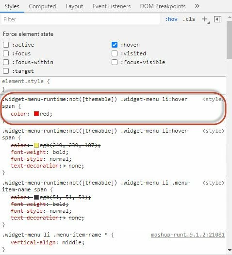

May 17, 2021 2:12 AM UTC
You can try below css code, it takes effect in my environment:
.widget-menu-runtime:not([themable]) .widget-menu li:hover span{
color:red;
