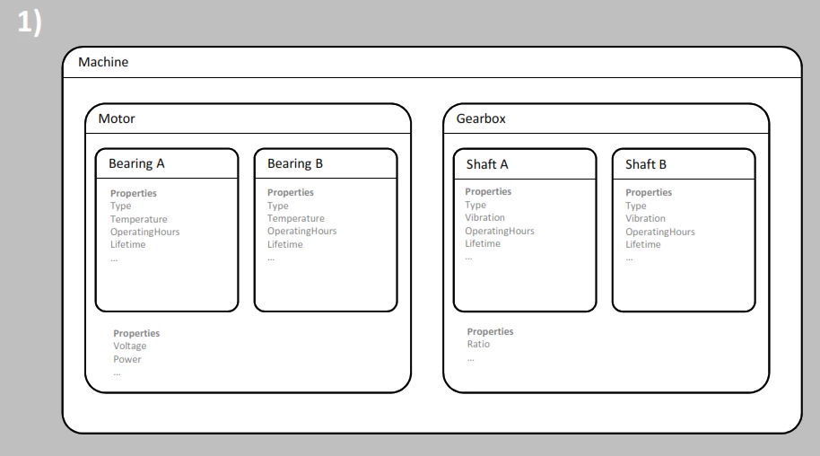

Principal Sketch 1) Real World Model Overview

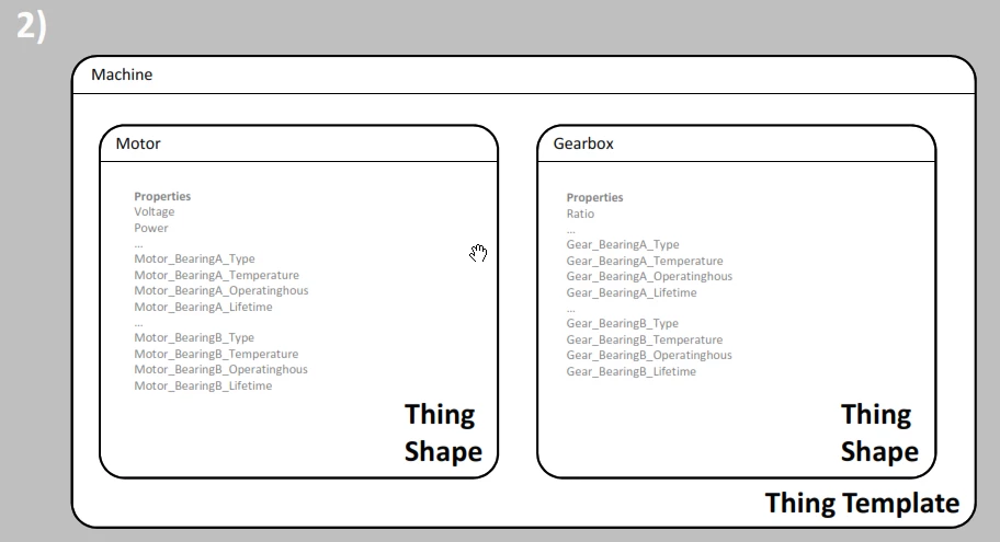

On one hand I can model the whole machine as one ThingTemplate and incoporate all the features via Thing Shapes (for reusability with other machine types that share the common features).
Principal Sketch 2) One Big Thing

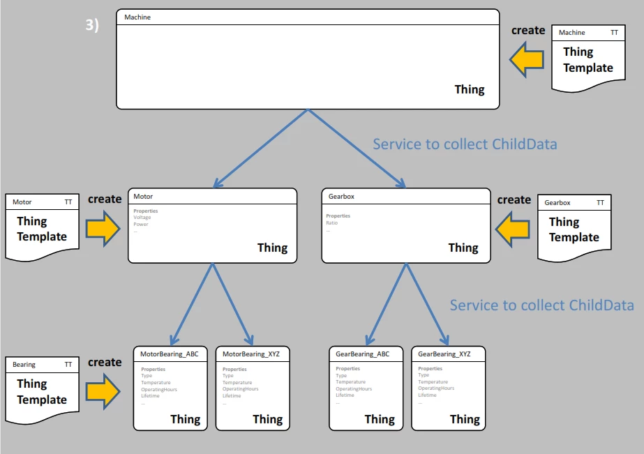

On the other hand I can model the whole machine by using different Things for the parts and use Services to gater the information from all them.
Principal Sketch 3) many small things

Best answer by CarlesColl
For what you say, I would chose the sub-things method (you can use Networks to relate the Things, as it's clearly a tree relationship)
January 22, 2019
