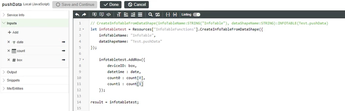

Tjaf1-VisitorAuthor
July 5, 2021
Here there is my postman Body : (you will notice that I don't have variable, only parameters)
Here there is my ThingWorx service :
By this way it's not working...
I tried also to put a json as in input parameter but I don't have the name of the JSON variable (if you look at my postman POST), so I don't know how can I select my input parameter...
Thank you for your feedback.
TonyZhangCommunity ManagerAnswer
Support
July 13, 2021
Hi
Looks like you didn't format the body correctly in Postman and you need to change the Input Parameters to json type in ThingWorx service.
