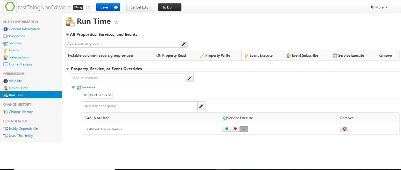

ranjank1-VisitorAuthor
August 17, 2020
@PaiChung ,
Let me tell you what I did till now:-
1) I have one testService in my thing "testThingNonEditable" (Screenshot1)
2) I have added one usergroup to runtime permission for Services in above thing, even after applying Deny to it the code is visible to the user of that and also it is not allowing to execute the service (I want users of a particular group would not be able to see code of this service but can execute.)

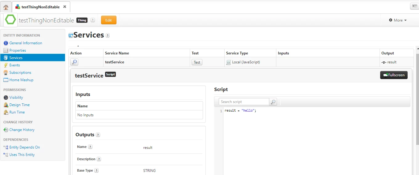

But as per screenshot2 he would be able to see the code of that service after login to composer.
Have added two screenshots for your reference.
