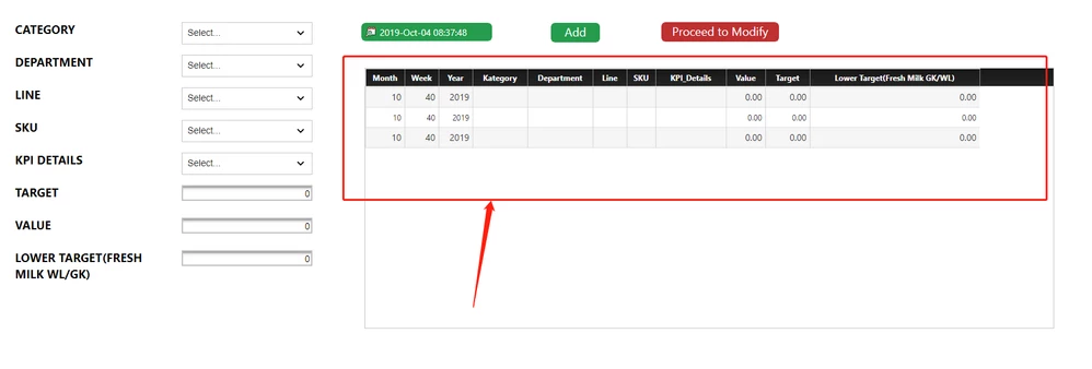

var week = me.GetWeekNumber({ date: when }); // Copied from Stack Overflow, didn't test its correctness
var month = when.getMonth(); // Zero-based
var year = when.getFullYear();
var correctmonth = month +1;
var query = me.CreateValuesWithData({ values: {
value: value,
Kategory: Kategory,
Department:Department,
Line: Line,
SKU : SKU,
KPI_Details: KPI_Details,
Target: Target,
Other_Target : Other_Target,
Other_value : Other_Value,
week: week,
month: correctmonth,
year: year
query.id = me.ID;
var params = {
sourceType: undefined /* STRING */,
values: query /* INFOTABLE*/,
location: undefined /* LOCATION */,
source: undefined /* STRING */,
tags: undefined /* TAGS */
if(me.ID !== query.id){
stop();
var result = me.AddDataTableEntry(params);
when I refresh the page, it will auto increment one more empty row in the grid widget.
how to fix this problem?

What exactly are you trying to accomplish?
Nothing in your code shows any sort of 'auto increment' of a primary key. This isn't something that Thingworx supports (compared to an SQl db).
I recommend if you need to track unique records, assign the Primary fields in the DataShape
if you just need to tag unique records, use GenerateGUID to assign a GUID per record
Perhaps if you explain your use case that could help generate proper recommendations.

Hi @PaiChung,
I just want to make sure everytime I refresh the page, primary key cannot auto increment and once I click "add" button, the new data will show in the grid widget.  Primary key should be in sequence.

Why don't you increment your primary key directly in the service which adds new record, right before adding it?
