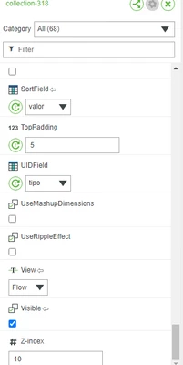

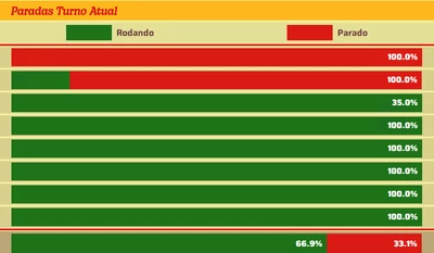

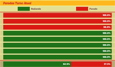

I am using the Collection widget in ThingWorx 9.3.3 to display a group of two mashups with different colors to simulate a percentage bar. I have nine simulated percentage bars like this, each separated by different containers in the main mashup.

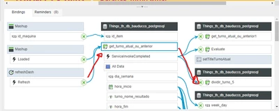

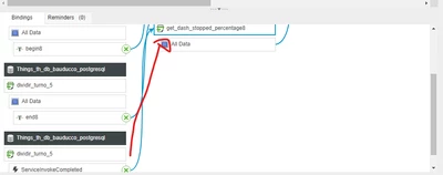

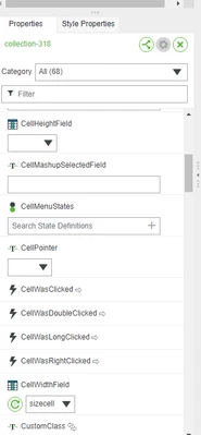

On the main mashup, I am executing a service every 30 seconds using Auto Refresh. The data from this service should set the width of the mashups using the "CellWidthField" property in the Collection.
I know that the Auto Refresh is working because I can see the percentage values updating every 30 seconds. However, the width of the mashups does not change accordingly, it only updates when I manually refresh the page. As you can see in the first image, the second percentage bar (which is 100% and red) should fill the entire row like the first one.
The second image shows the correct behavior, but only after a manual page refresh. The width of the mashups in the Collection appears as expected after the page is reloaded.
My question is: How can I use Auto Refresh to update the mashup width in the Collection without having to refresh the entire page?

Jul 8, 2025 8:28 AM UTC
I tried on TWX 9.6.1 and it did refresh cell width and height for me on auto refresh.
I was using View "Flow". When using "Table" it always uses the full available width, not considering my cellWidth. But I think this is wanted in this view - not sure.
I am not sure of your exact setup. Maybe you can provide a sample which has the issue. So I could retry in my version? If this is of any help.

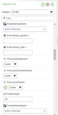

Jul 8, 2025 11:25 AM UTC

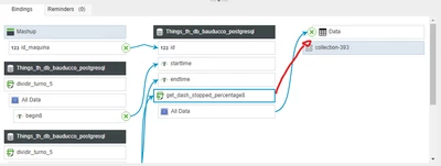

Yes, I'm using the Flow visualization. I'll share some pictures of the collection settings and how the data flows into the widget.

There's a standard Shape widget, which can be used for displaying progress bars. Configure it like this:
1. Width / height -- to fill your collection cell
2. EnableDynamicFill: YES
3. DynamicFillOrientation: Horizontal
4. Style: Something with a background 🙂
Bind your percentage number to its Data property.
