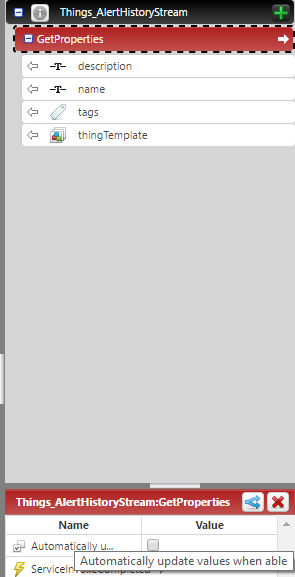

Is the status of the device a property? If so, as of TWX 7.1 (if I remember correctly) you can use websockets to update the property value instead of the refresh widget. Use the service GetProperties on the Thing or the Dynamic ThingTemplate/ThingShape and select the service in the mashup. On the bottom right, select the check mark for "automatically update properties when able"
Now, when the user changes the property, it should not refresh the property before the update is complete.
