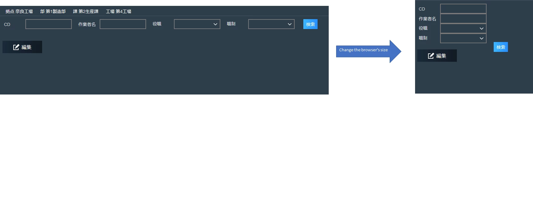

Hi @Quannd.
So that we can ensure we're on the same page, can you provide a mock up of what you're looking for?
Regards.
--Sharon
Quannd1-VisitorAuthor
July 24, 2019
Hi @slangley,
I did attach the mockup, please check it.
Thank you.
