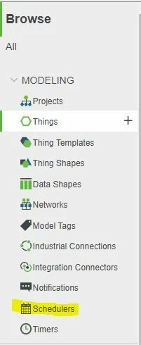

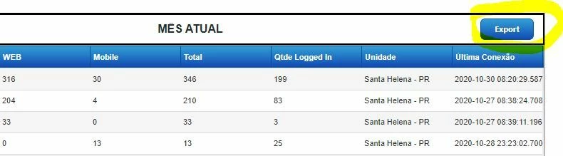

Hi everybody,
I am working with data export widget to export data from my data table. It is working well.
I would like to schedule one time to launch this widget everyday rather than I do it manually.
I have been thinking to use the function "schedulers" to does it:
Does anyone know if this is possible?
Best answer by PaiChung
To trigger this automatically you can use a scheduler, then a service to pull the data and then save it as CSV to a Thingworx file repository.
This can all be done server side so you don't need to have a mashup open to trigger the Data Export widget
