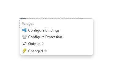

I created a thing with a string property. I also created a mashup. I want whenever the value of property changes, the mashup available to end user should refresh. How can we implement it. I tried many options with data change event on property and calling different services  in mashup but nothing works.

Hello @aschauhan646 ,
Try to use Expression or Validator widget to find value change and use 'changed' event to refresh mashup
Refer below PNG
