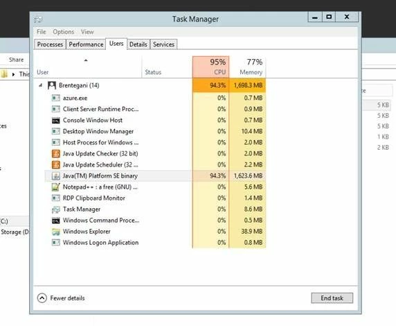

When I started the thingwox connector (which was always good for an abundant year), thousands of threads were opened constantly and grew.
This caused the saturation of RAM and CPU memory:
and when I tried to send C2D messages or read D2C message in thingworx log it was as follows:

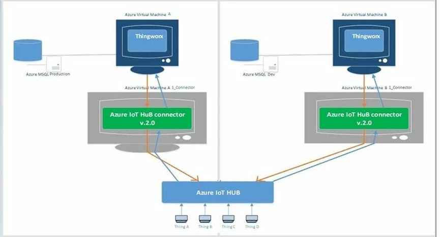

The architecture used until now is as follows:
On iot hub there are two different consumer groups for each connector:

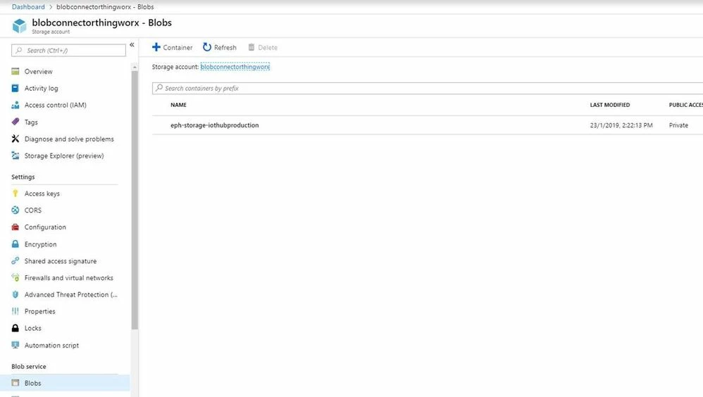

The connector uses an Azure storage account.
1) At the suggestion of Stephane I deleted all the blobs created by the connector:
2) He sent me some lines to add in the connector configuration:

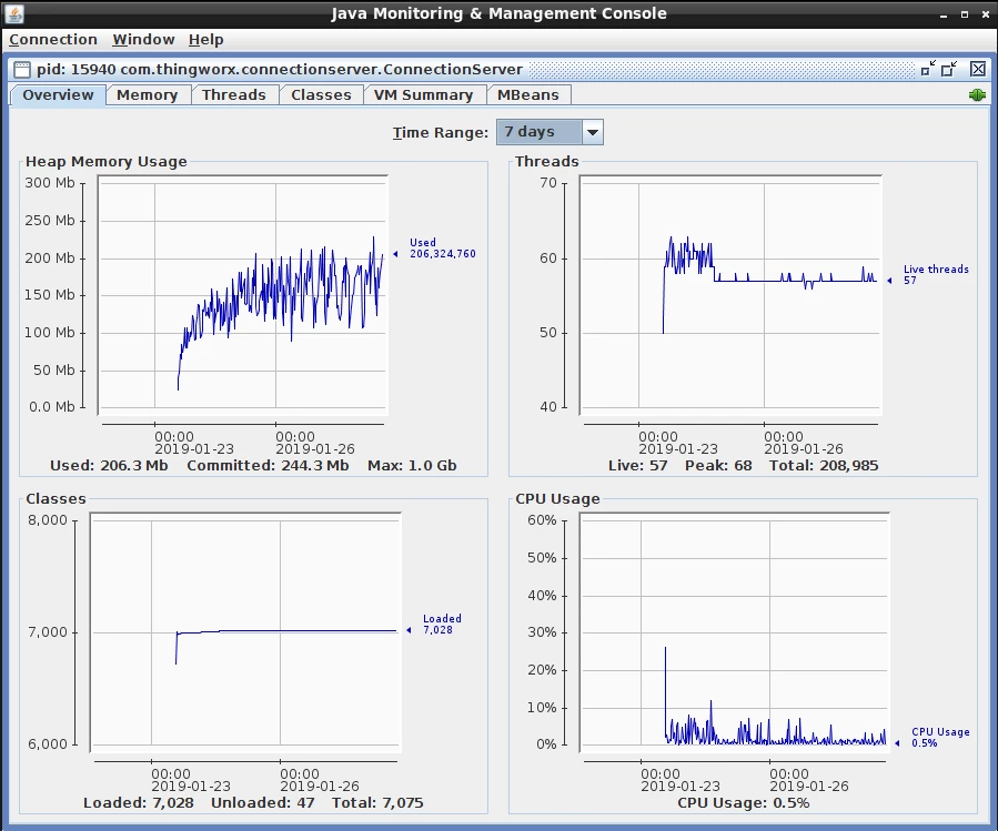

3) Restarted the connector.
Threads are now of normal value[50-65]. [during problems increased over 5000 threads].
Here below the proof of normal functionality of the thingworx connector.
