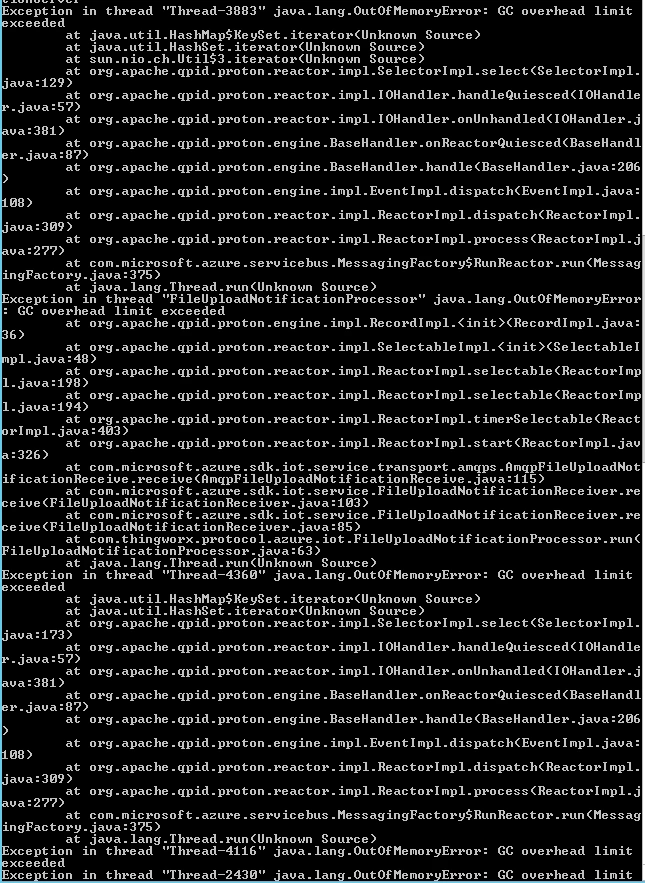

I had a consumer in node-red, so I consume all the messages.
I noticed in the azure iot hub connector bash the following error:

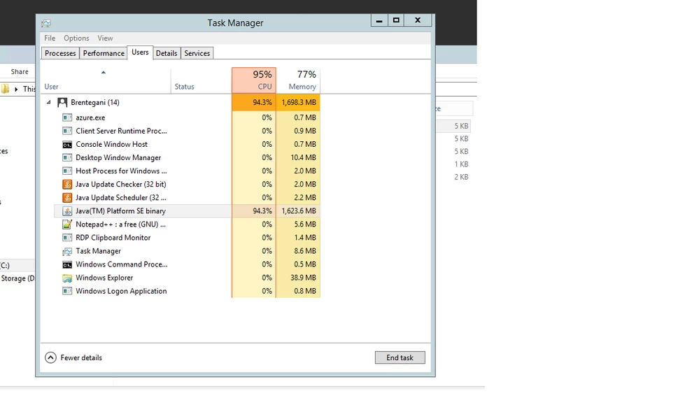

The virtual machine is a Windows server 2012 R2
4 GB Ram
Intel(R) Xenon CPU E5-2673 v3 @ 2.40 GHz
java = jre1.8.0_92
After 1-2 hours of startup, the connector continues to require so many resources until the error occurs:
After the error I have to restart the connector in order to use C2D and D2C messages.
Any suggestions????

Can you please analyze the log of the connector?
I think there is the cause of the using a lot of resources.

It doesn't appear that you have sufficient RAM.  Please refer to the Requirements doc for validating your configuration.
