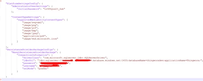

I am trying to connect an Azure SQL Managed Instance database to ThingWorx. I can connect the db using the creds from platform-settings.json in SQL Server Management Studio(SSMS)., but when I try to communicate through Thingworx, I get the following error:

2025-07-22 00:07:54.110-0700 [L: ERROR] [O: c.t.s.ThingWorxBootstrapper] [I: ] [U: SuperUser] [S: ] [P: ] [T: main] *** CRITICAL ERROR ON STARTUP: Connections could not be acquired from the underlying database!
This is how platform-settings.json looks:
The Thingworx Version of the Upgrade is 10.0

Did you setup the DB with the proper scripts?
maybe related (but not Azure): https://community.ptc.com/t5/ThingWorx-Developers/not-able-to-connect-to-thingworx-server/td-p/745295
https://www.ptc.com/en/support/article/CS285545
https://www.ptc.com/en/support/article/CS312127
Also check if you want to set more relaxed parameters in platform-settings, see section persistence providers -> MssqlPersistenceProviderPackage

Thanks for sharing the articles. I have already gone through them. With the help of an article, I have created a persistence log in Apache. When going through the log, I continuously see an error:
java.sql.SQLException: No suitable driver
Attached is the log.
Shashi Preetham || +91 8099838801 || shashi@psptechhub.com
Rocko
Jul 22, 2025 9:00 AM UTC
"no suitable driver" means something is wrong in your setup. Check which driver jar is used, and that there are no conflicts in the classpath. Also that no extension brings in a different jar.
Then, make sure it's the right driverclass you refer to, the classname should be in the driverpackage being used.
And just to make sure: TWX for AzureSQL is a different download than TWX for MS SQL, I hope you noticed.

The issue is solved. I have followed a video from the PTC itself, which was buried in the Help Centre, and that helped me move forward from this error.
Video Link: 10 FAQs on ThingWorx with Azure SQL - PTC Community
