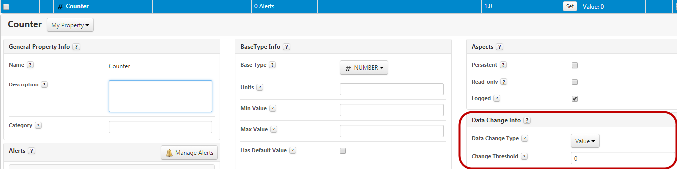

I have different thing that have several properties. One of this properties is a integer "Counter" that for each PUT increment the value of this counter. Each thing has its own ValueStream.
The question in general is that I would like to retrieve the history of this put.
I have try to obtain this with querypropertyHistory but it happens that some row return duplicated and I don't know why.

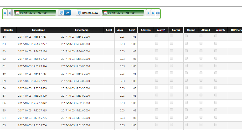

The oddest thing though happens when I look at the behavior through a mashup where I put the QueryPropertyHistory service commanded by a timeselector and autorefresh.
Iit happens that at a given instant the service shows the duplicate row (same counter) and the next step is replaced by the row with the incremented counter.

I don't think this is the correct way of storing this kind of data.
Let's start with some basics:
  • ValueStream -> It's purpose it's to store one property at a time, ValueStream storage structure: timestamp, propertyName, value
  • Stream --> It's purpose it's to store one or more values at a time, Stream storage structure: timestamp, value1, value2, value3, valuer4,...
In your case I think you should go for Stream storage instead of ValueStream, as you want more than one property recorded at the same exact time and this won't happen with a ValueStream approach. What happens with QueryPropertyHistory it's it creates a fake complete row for each different timestamp that you have on any recorded property, copying previous value for empty properties on that exact timestamp.

Can you make sure that the property data change info is set to value? I am not able to recreate this issue. What version of TWX is this on?
Alternatively, you can use the service UpdatePropertyValues ​to update the property with a value, timestamp, and quality. If the timestamp and value are the same, this will prevent the additional counter from being logged.
lguagneli1-VisitorAuthor
Oct 9, 2017 3:07 PM UTC
This property has Data Change Type to Value.
Ok! I can use UpdatePropertyValues, but I'm quite sure that the Counter increments each PUT the device .
