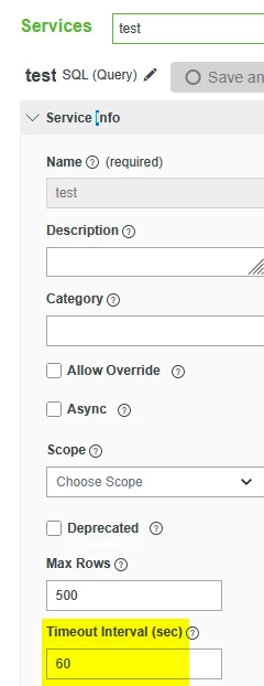

Aug 14, 2026 10:48 AM UTC
Not sure how you trigger the SQL currently, but if with SQLThing: You can set query timeout per service:
Which is great :) PTC support showed me that option and I was amazed as I did not spot it myself.
