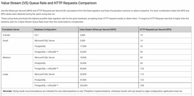

September 14, 2022
Hi @SP_10199785
In that case, you need to look down at this table, 5000 API Calls mean 5000 HTTP requests per second. You need to queue it manually to match this RPS base on your ThingWorx Server Size.
https://support.ptc.com/help/thingworx/platform/r9/en/index.html#page/ThingWorx/Help/Installation/Sizing/compare_sizing_criteria_to_guidelines.html#
