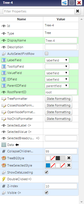

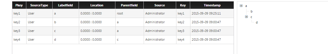

Mar 9, 2016 10:29 AM UTC
Sandeep,
As an example, you could create a DataTable, and give data like on left:
Then you could set configuration in the Tree widget as:
Finally when you run the mashup, the Tree widget will load the data properly(as shown on top right picture). make sure that you have the the parentIs properly set which should be the id of its parents' Labelfield, and the leave the root node's parentId as "root" or something, and finally set it in the Tree widget configuration in accordance.
Hope this helps.
