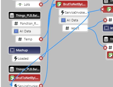

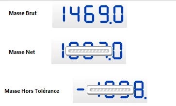

Hello All
I have created services for each LED in order to visualize the data, services work perfectly but LEDS are updated all the time as you can see in the photo below
I added a trigger serviceInvokeCompleted to visualize the updated data but it creates a weird binding each time I try to connect it to my service :
Could you please tell me why that happened, and what can we do to solve this issue
Thank you for your answers

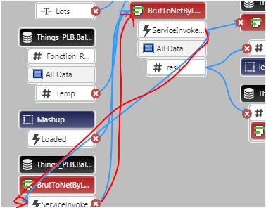

Aug 11, 2020 2:35 AM UTC
Hello @Ziyad
Please see the added red line, these two services then call each other
BR,
Max
22-Sapphire I
Jul 30, 2020 1:21 PM UTC
You've created an infinite loop as you can see from the blue binding coming all the way around back to the front.
Please eliminate that and think of a different way to do your event flow

Ziyad1-VisitorAuthor
Aug 13, 2020 1:27 AM UTC
Thank You for your answers the small problem was resolved,
I had services whose entry depended on the output of other services and the events had to be reorganized a little
