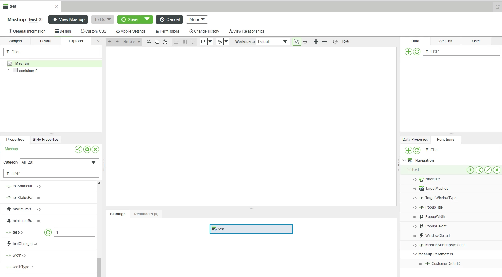

I am testing ThingWorx 9.0 before upgrade of our project from 8.5.5, and I have a problem with binding parameters in Navigation Function in Mashup.
Preparation:

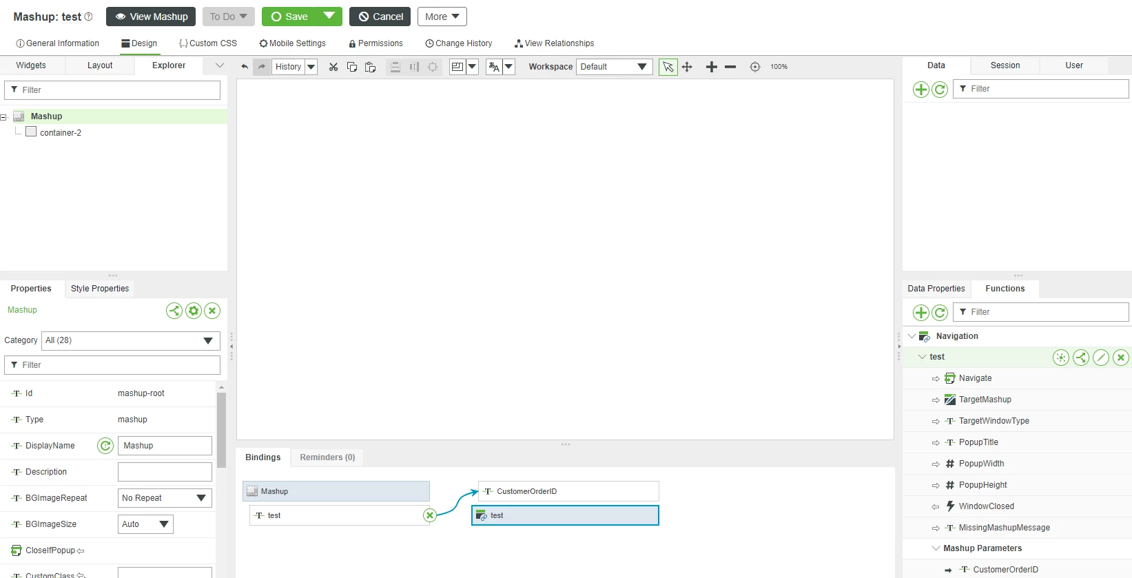

I created test Mashup using Responsive layout. I added a Parameter with a default value (source for Navigation Mashup Parameter), and a Navigation to a Mashup with a Parameter. I manually (drag and drop) bind this Parameter to the Mashup Parameters in the Navigation.
Problem:
After I change active entity in Composer or refresh the page, I get the message "Obsolete bindings for test were removed".
Same thing happens when I bind this parameter with a value coming from a Widget or a service output.

I've read the article you mentioned, and I'm afraid I have a different problem. There are some differences between those 2 cases, mainly:
  1. I didn't use Legacy layout in Mashup, it was newly created responsive Mashup
  2. I didn't use legacy widgets
  3. The problem accusers when I use drag and drop. Binding via Configure Bindings is not possible, because when used the "Obsolete bindings for test were removed" message appears immediately.
My problem is that the dragged and dropped Parameter unbinds at the page refresh. After binding and saving Mashup the Parameter appears connected, although it does not work at Runtime, the Parameter is never bound.
