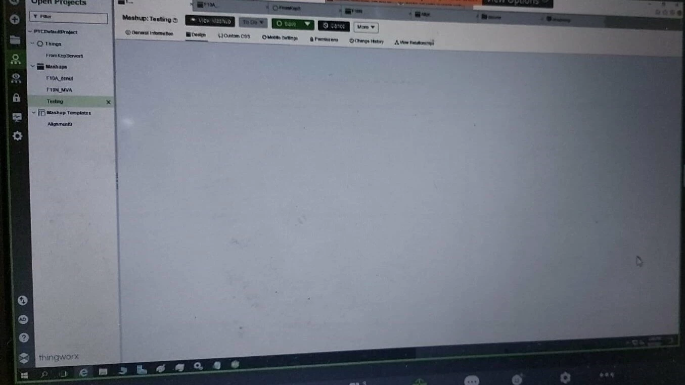

Blank mashup appears in Composer
Have created few mashup and things using online 30 days trails provided by the thingworx & i wanted to migrate this mashup & thing to the local instance of thingworx  (i.e. ThingWorxFoundationH2Trial-9.1.0-x64). After installing the thingworx on the local machine, the mashup in composer appears blank when try to create a new mashup or even try to open any imported template..

1> Do you access to the system via Administrator or other roles?
2> If the user has enough permission, have you tried to use other Browser?
3> You can turn on Developer Tools of the browser (General you can click F12) and see if there are any errors in the client
4> Check Thingworx Application log under <ThingworxStorage>/logs
