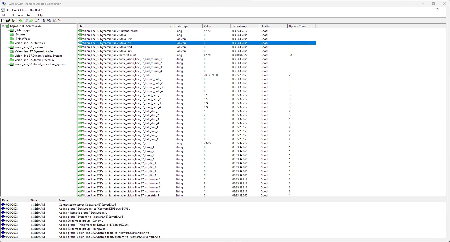

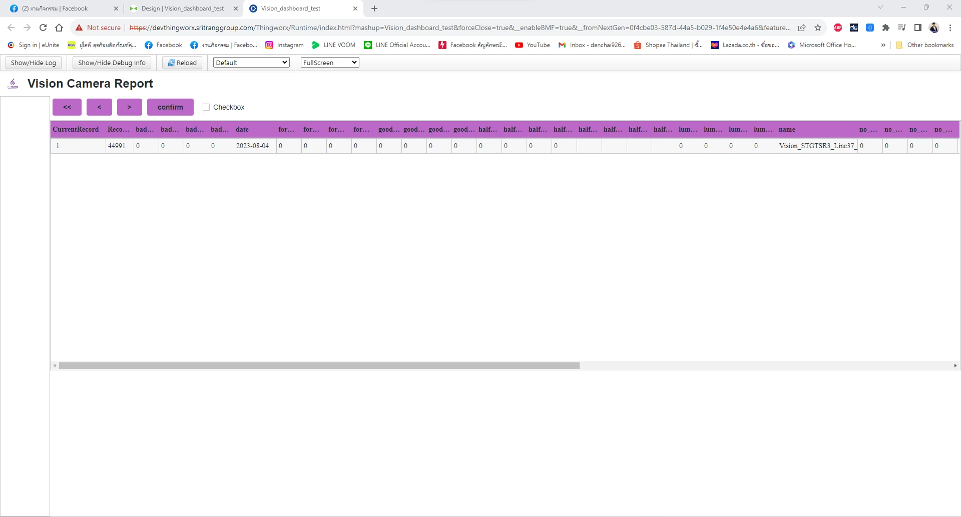

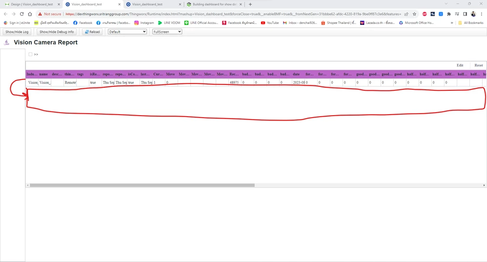

Building dashboard for show data from Kepware ODBC Client
Now i try to make dashboard for showing data from MSSQL to Kepware in ODBC Client (as picture 1) and input to ThingWorx for showing as dashboard. But i cannot show all data that save to MSSQL can show only 1 row (as Picture 2) and can use Move function only (as Picture 3) but cannot next at mashup and search by date and time. How can i show all data and sorting by date and time? Thank you.

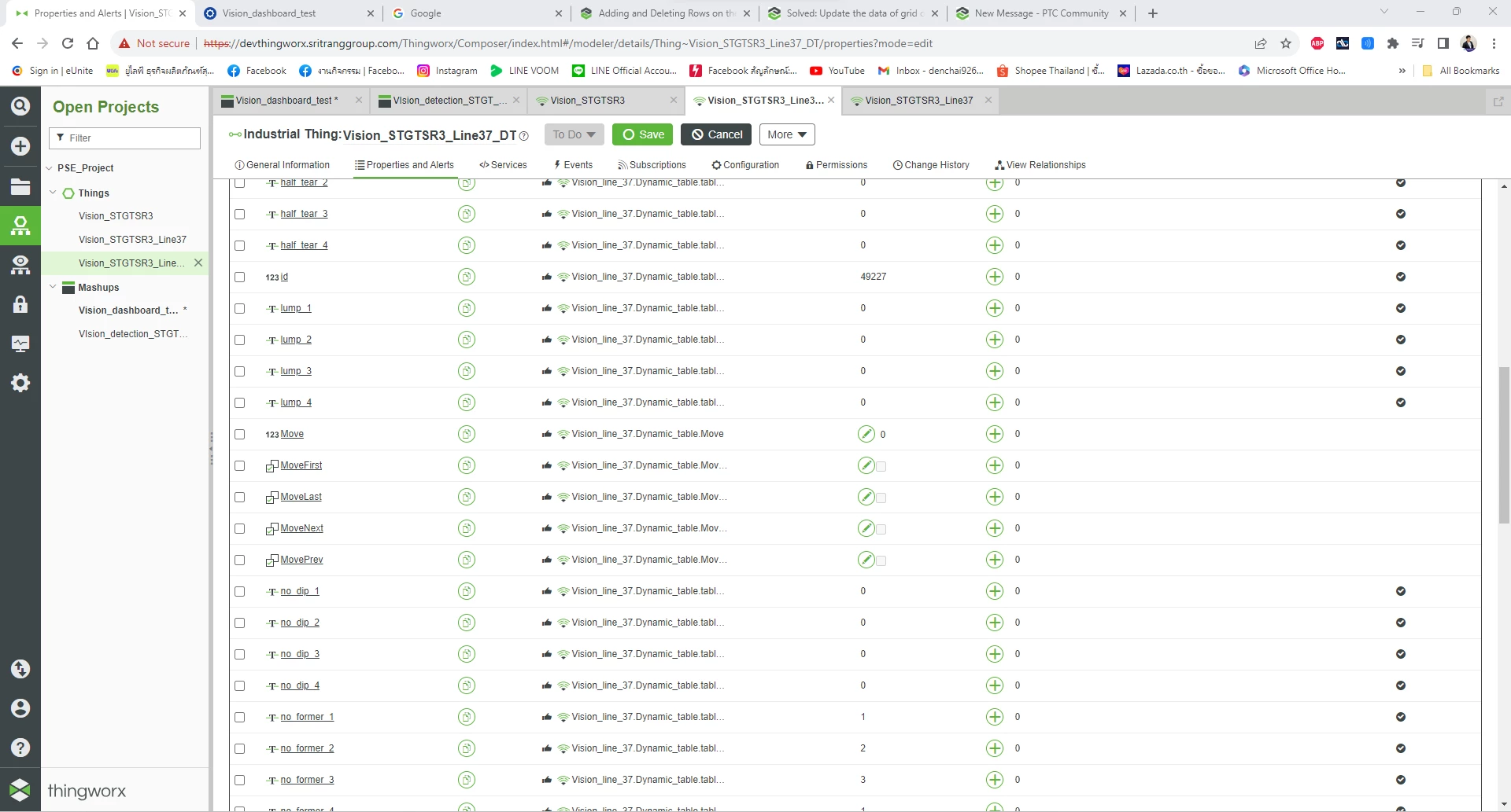

Hi @DR_10558933 ,
If I'm understanding your query properly means , you want to display the live data on mashup like Thingworx composer. In that case you can find default Industrial Thing > Service of GetPropertyValuesAsMultiRowTable, It will display the infotable data as multi rows with Status, Value, Last Updated Date Time.

Sep 21, 2023 6:15 AM UTC
Can i build new row when execute like this photoScreenshot 2023-09-21 131340.png?
